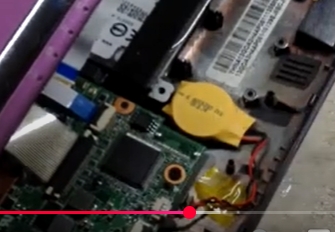

I found what's needed to change the battery and I reckon there are too many things that could go wrong!

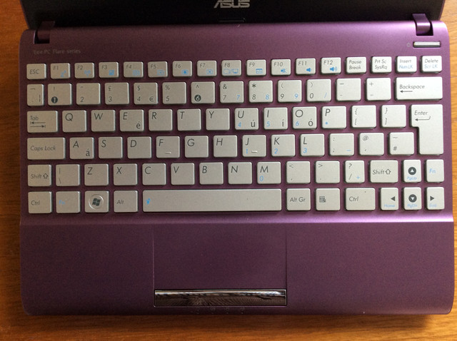

I decided to take the plunge and replace the CMOS battery.
My Asus eee PC is a Flare Series model where the keyboard is part of the body which was quite fiddly to remove but once it was removed there was no other part to remove (apart from the battery and 5 screws).

I'd been looking at how to replace the CMOS battery for Asus eee PCs which involved a lot of dismantling which put me off.
Then I realised it was a Flare Series model which has a different cover with the keyboard built in.
